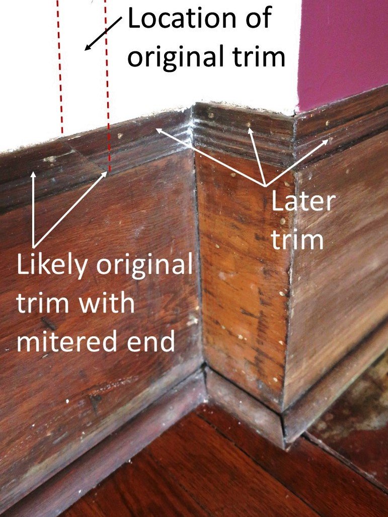

Meanwhile, the house is revealing small clues about its past, even before Harboe Architects begin their investigation in earnest. A significant portion of the original interior trim has been removed, but traces remain that will be critical in the restoration of the major interior spaces. An example of this is found near the living room fireplace. While the marble facing and ionic columns of the fireplace niche have been removed and other details altered, a close inspection of the woodwork in the area, compared with Wright’s drawings and the one known historic interior photo, indicates that much original trim remains intact. The profile of the molding that caps the baseboard in Wright’s drawings appears identical to the existing molding. Also, a mitered cut in the existing cap molding shows where vertical elements once were located. Small clues like this will be important to understand and ultimately recreate the house’s original detailing.

Baseboard and wood work at the north end of the fireplace alcove, current conditions.

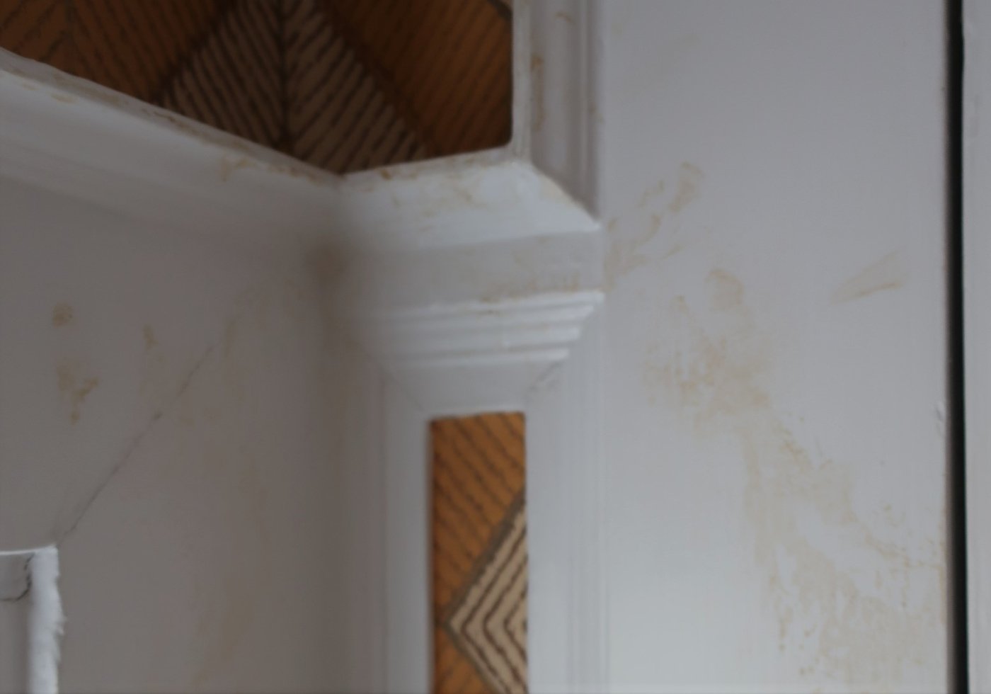

Possible remnant section of picture rail, Bagley House.
The degree to which Wright’s detail drawings were adhered to in construction has yet to be determined. Wright called for picture molding throughout the first and second floor of the house. Was this molding installed? A remnant in one of the second floor bedrooms indicates that it may have been.

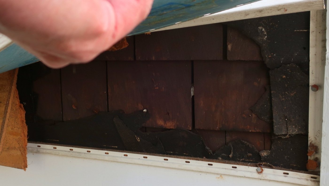

In early December, Jean and Julia visited the house to do photography for the nominations. They met with John Waters and all three shared their research and insights into the history of the house. As part of the nominations, Julia and Jean will be reviewing the degree to which the house retains original features and materials. This is known as “historic integrity.” A major question was whether there was evidence of the house’s original wood shingle exterior. So Jean, Julia and John peeled back the modern siding in two locations, and indeed, clear evidence of wood shingles remained! Whether these are the original shingles or not is yet to be determined, but what was revealed appears consistent with the earliest known photos of the house.
Shingles on the front elevation, Bagley House
Shingles on the rear of the octagonal library, Bagley House
