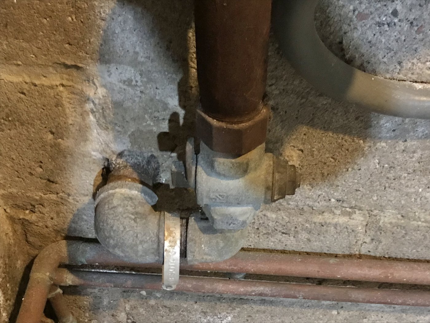

Our story began with a door hanger left by the gas company announcing what promised to be a routine inspection of the natural gas meter in the Willey House basement. The scheduler assured me it would take no more than 10 minutes.
On inspection day, Gasman #1, a fidgety chain smoker, arrived early. After a few minutes in the basement he emerged and reported that the gas line looked a bit sketchy to him. He needed to call Gasman #2 to examine the inlet pipe to appraise its condition. If his suspicions were correct and the pipe had exceeded its useful life, they’d want to replace the line and relocate the meter to the outside of the house. In that case, Gasman #3 would be called in to determine how soon.
One hour later, the Bedford Street SE cul-de-sac resembled a utility parking lot, as Gasmen #3, 4 and 5 arrived, each in his own truck. There was a concerted head shaking among them, punctuated with staccato bursts of gas line jargon as they paced to and fro, studying the atypical installation. The gas pipe ran underground from the street to the small basement below the Willey House kitchen. The completion of this journey required a 90-degree turn where the pipe entered the basement wall. Not so strange really, except that the last leg travelled under a sunken, brick paved walkway.
Photo by Steve Sikora
Despite what seemed like an obvious route, their equipment was unable to “locate” the precise path of the pipe using an electromagnetic signal. But company records showed that the original metal pipe was lined with a plastic sleeve in 1979. Their inability to get a locate signal was explained away with the speculation that the ferrous metal pipe had been severed during the polyethylene retrofit. No current flow, thus no signal. I was not alarmed, until one of them suggested that they might have to tear up the brick walkway to access the pipe. The covered walkway was paved in alternating courses of original and irreplaceable Menominee and Chaska bricks that had not been disturbed in 87 years. I told them the bricks could not be touched, “and I’m here to protect them.” Gasman #3, snapped back with, “and I could turn off your gas!” Though it was mid-summer, I was sure I’d need gas again in a few months.  So after our initial hasty declamations, we began productively seeking common ground. The rough plan we devised was to place the meter further back on the north side of the house, where it would be concealed behind bushes. They’d tie into the polyethylene gas line from the main in the street. Push pipe underground to a pilot hole dug under the new meter location using a trenchless Ditch Witch. From there, copper pipe would be run above grade from the meter, along the wall and into the basement. I wasn’t delighted with the aesthetic aspects of the plan but could see no better options and frankly none were offered.

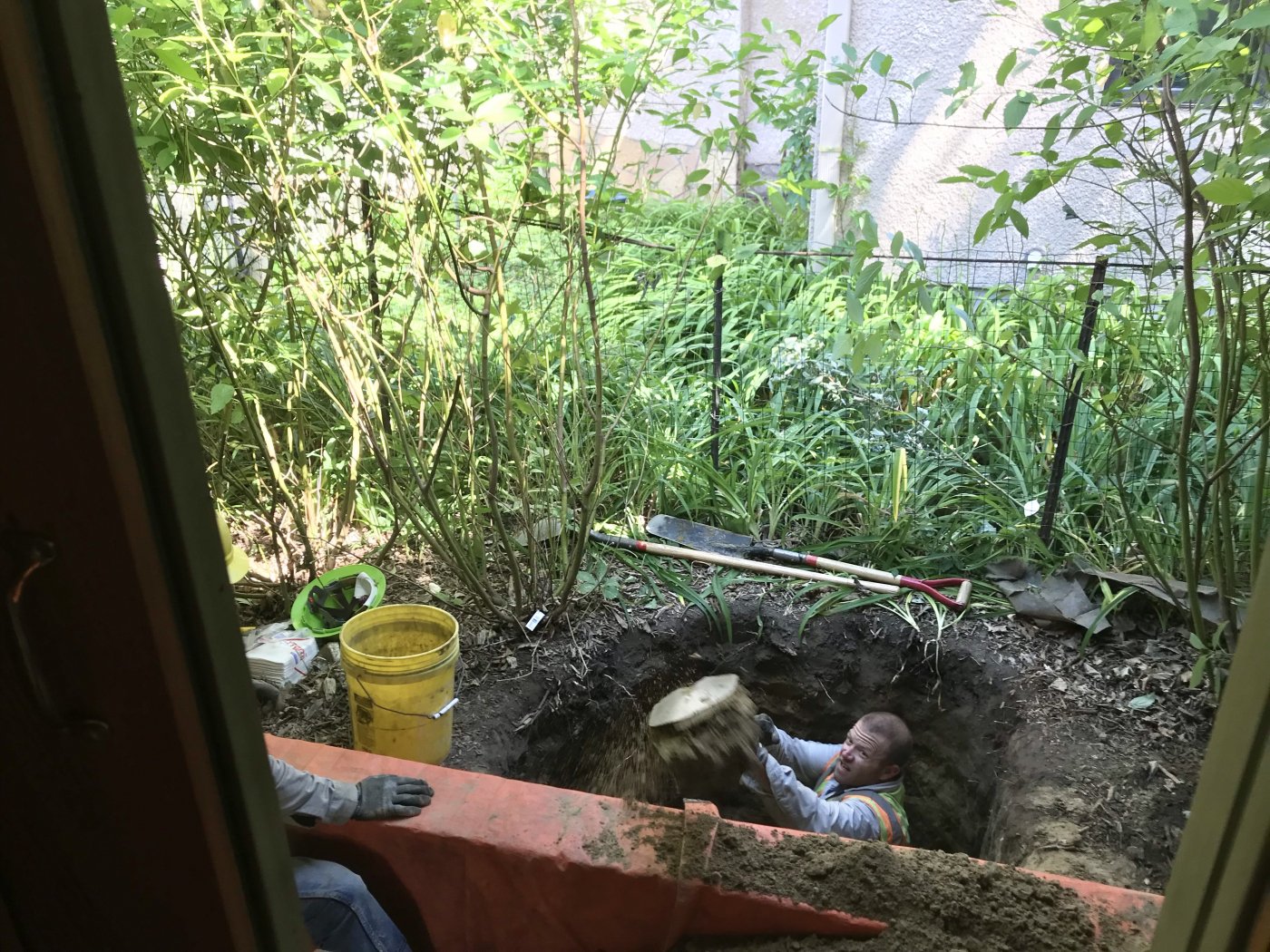

I tried to stay out of their way, but when the walkway was brimming with topsoil, I ventured out to check in on the proceedings. Excavation these days is largely accomplished by machine power. It was evident that shovel digging a nine-foot deep pit in the summer heat, was not what an ordinary workday looked like to this aging crew. The young guys, it seemed, just happened to take vacation days. Lynette and I decided to offer up pizza for lunch and the proposition was met with enthusiasm all around.

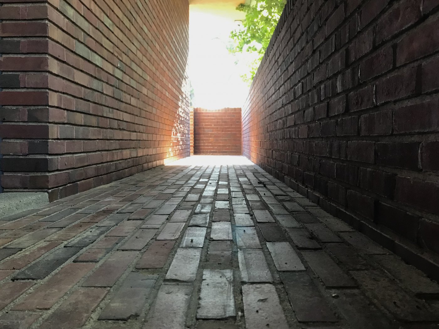

For whatever reason, it was there. It was original. It was rusty as hell. The corroded pipe under the paved brick walkway erased any shadow of doubt that the line dated back to the construction of the house. Also because it ran under the old oil tank and was buried deep beneath bricks laid in 1934/35, it could not have been placed after construction. The deteriorated condition of the pipe made it abundantly clear why in the late seventies, all original gas pipes in the neighborhood were retrofitted with a polyethylene liner.
But now we had a real problem. Without waiting for the foreman’s next move, I volunteered to personally tunnel from the pit beneath the brick walkway to the basement wall. I was told that for reasons of liability they could not allow that, but my willingness must have impressed them.

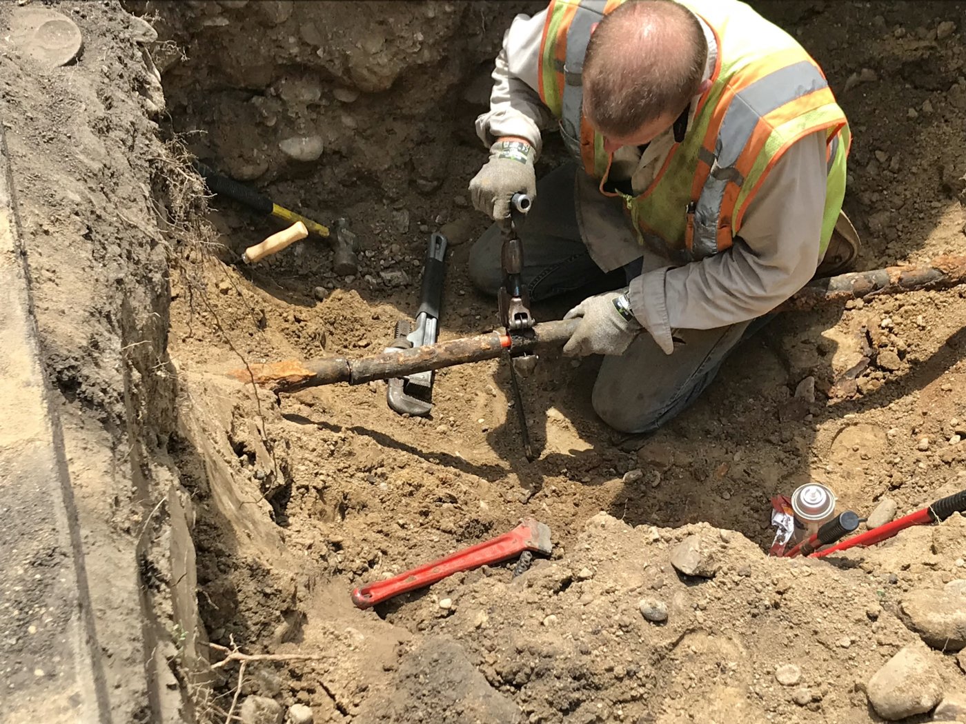

He descended to the bottom of the pit and using only a long-handled spade, carved out a tunnel to the pipe elbow. He was able to reach the junction and complete the splice without endangering his life or collapsing the walkway. New polyethylene pipe was pushed from the street to the meter and then back to the bend. Another PE pipe was pushed from the basement out to the pit where the foreman gleefully proclaimed, “all the dots are now connected!”
