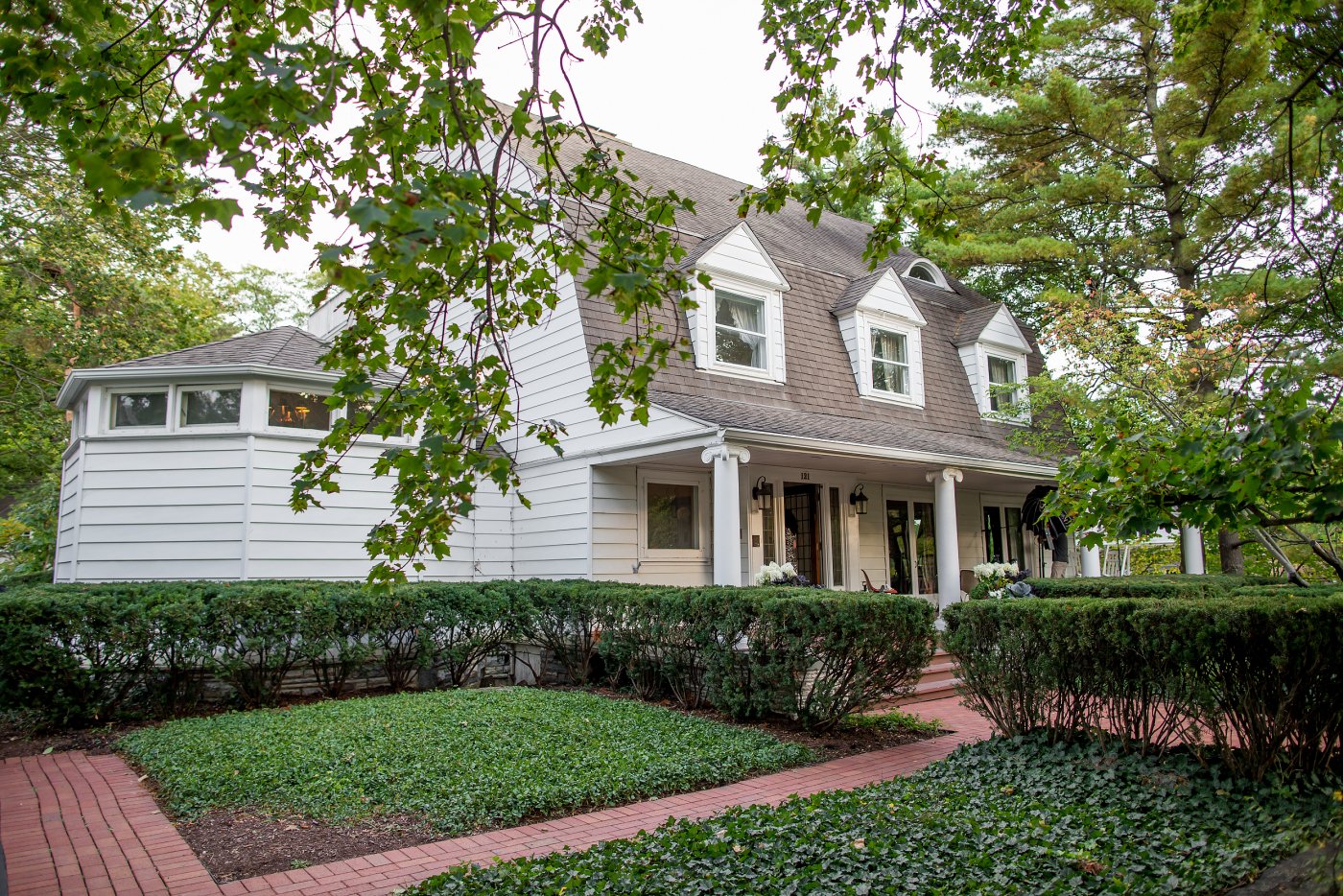

In February, Safina Uberoi, who owns the Frederick and Grace Bagley House in Hinsdale, Illinois, with her husband Lukas Ruecker, sat down with Anthony Rubano,  Illinois Deputy State Historic Preservation Officer, and with the Building Conservancy’s John Waters, to learn more about Illinois’ tax assessment freeze program and how it may assist Safina and Lukas in their restoration of the Bagley House.
Frederick Bagley House photo by Marcello Rodarte
